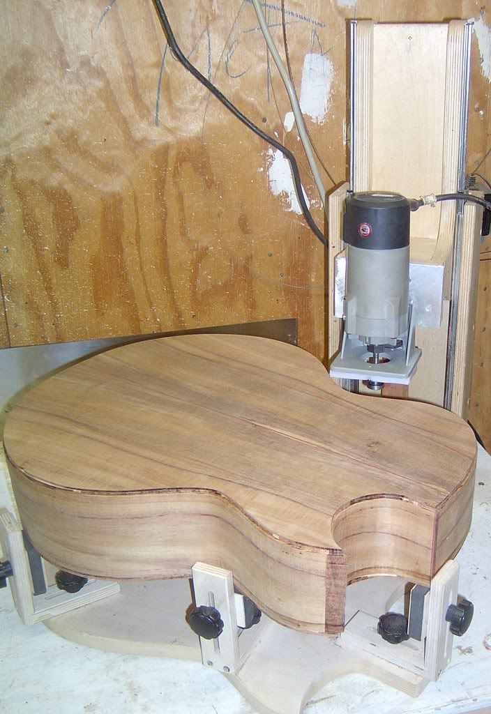

I bought my new binding trimmer tooling from John. I really like it.
It is so much better than my old way. I just finished doing 2 guitars.
Both of the sides have a pretty good groove from the bearing. Is there a trick to avoid this?
I'm sure someone will say that I am just pushing too hard, but I don't think I am.
You can see the indentation on the top and bottom from the bearing in the picture below.
SteveS39012.9386226852

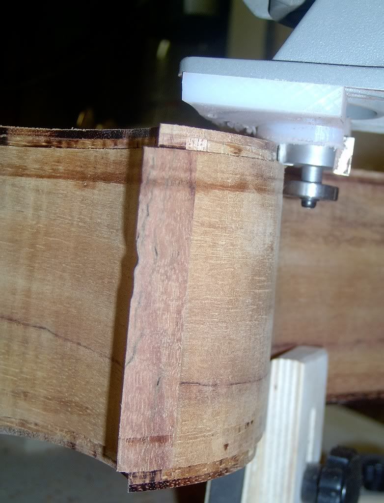

PostPosted: Sun Oct 22, 2006 1:40 pm
are you sure that your bearing is turning freely?
PostPosted: Sun Oct 22, 2006 1:48 pm
Posts: 1023
Steve,
Michael stated the most likely cause. I have found that if you don't push
too hard against the sides and the bearing is well lubricated, you don't
cause those marks. It make 3 passes and go very light each time.   Also,
going to slow seems to cause them for some reason. I think it is more of
a feel thing - as I have done mahogany and walnut before with no
trouble. In other words, they don't happen to me any more after I have
been using that jig for a while now.
The other thing I noticed from your photo is that the plastic shoe that
rides atop the guitar is very rough. Take some sandpaper and round it
over and then smooth with subsequent grits up to about 1500 grit. The
first time I used my Ribbecke style jig, the shoe was rough and its edge
tore some of the grain on my cedar top - nothing permanent but it can be
avoided if you make it smooth.
By the way, I really like the bloodwood binding on that koa guitar - it
looks awesome.
Peace Out,
SimonSimonF39012.9559606481
PostPosted: Sun Oct 22, 2006 1:50 pm
Posts: 2995
Steve, Ive always gotten that too and just accepted it. They usually scrape/ sand out without much difficulty.
I'd be nice if someone has an answer for it however.Jim_W39012.9530555556
PostPosted: Sun Oct 22, 2006 2:02 pm
Posts: 908
Does the bearing spin very freely? You may need to "break it in" on some scraps, or by tying the bearing up with some tape and spinning the router for a few minutes.
Also, it can very well be that you're not pressingt he bearing against the side hard enough. If you don't hold it tight enough, the bearing will spin, causing those burn marks we see....
PostPosted: Sun Oct 22, 2006 2:34 pm
Posts: 1969
The bearing spins freely. What do you guys recommend for bearing lube.
Hesh, yes the bearing is a bit tilted in that picture. The other guitar was EI rosewood and the bearing was straight for that one. Although the wood was harder, it left the same dent.
Steaming it out sounds like a hot tip.

PostPosted: Sun Oct 22, 2006 3:22 pm
Steve, is your bearing free and perfectly horizontal? it looks rather tilted from the picture...not perpendicular..
PostPosted: Sun Oct 22, 2006 3:37 pm
Posts: 1969
Peter,
The bearing free? Are you kidding? Those things are expensive!
The bearing is free and was not perfectly horizontal for that guitar. But it makes the groove even when it is perpendicular.

Steve those marks are caused by the bearing rotating with the cutter. You can see the burn marks on the Koa. The bearing should not revolve with the bit but just roll as you make your cut. Try watching the bearing while you cut on a piece of scrap wood. As an added precaution you can apply masking tape around the body where the bearing rides.

This is one of the advantages of using a bearing mounted on the laminate trimmer rather than the router bit. Unless the bearing is sealed it will pick up wood dust very quickly and bind it up, and turning at 30k revs will certainly burn the wood. If you free hand use a guide-bearing mounted on the trimmer and a downcut bit. If using a Williams/Fleishman jig just add the Dave White modification when using the trimmer based guide-bearing/downcut combo.

Most bearings are packed with a heavy grease that sometimes keep them from turning fast enough to keep up with a router. As Mario suggested, you can run them for awhile to break them in. Another approach is to take out a seal, and soak in solvent to remove the grease. Blow it out with compressed air and then lubricate it with something that is more suitable for higher rpms. I use "speed oil" which you can get a skateboard shop.
